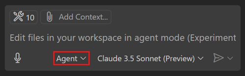

  1. Open the Chat view (⌃⌘I (Windows, Linux Ctrl+Alt+I)) and select Agent from the chat mode selector.
    Screenshot showing the Chat view, highlighting agent mode selected.

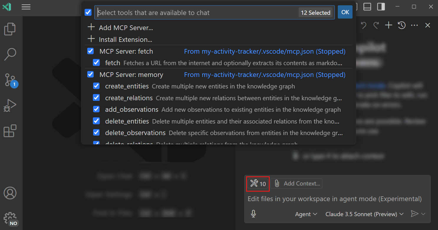

  3. Agent mode might invoke multiple tools to accomplish different tasks. Optionally, select the Tools icon to configure which tools can be used for responding to your request.
    Screenshot showing the Copilot Edits view, highlighting the Tools icon in the chat input.
    Tip
    You can also directly reference a tool in your prompt by typing # followed by the tool name. You can do this in all chat modes (ask, edit, and agent mode).

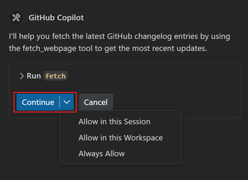

  4. Confirm tool invocations and terminal commands.
    Before running a terminal command or non-builtin tool, Copilot requests confirmation to continue. This is because tools might run locally on your machine and perform actions that modify files or data.
    Use the Continue button dropdown options to automatically confirm the specific tool for the current session, workspace, or all future invocations. Learn how to manage tool approvals and approve all tool invocations.

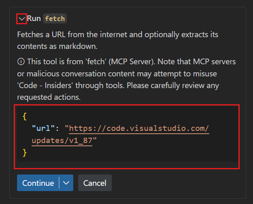

  5. Optionally, verify and edit the tool input parameters before running the tool.
    Select the chevron next to the tool name to view its details and input parameters. You can edit the input parameters before running the tool.
    MCP Tool Input Parameters

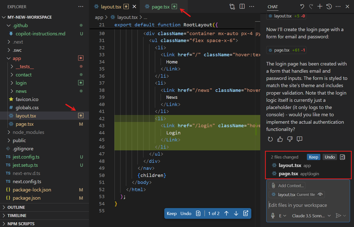

  7. As Copilot processes your request, notice that Copilot streams the suggested code edits directly in the editor.
    The Chat view shows the list of files that were edited in bold text. The editor overlay controls enable you to navigate between the suggested edits.
  8. Review the suggested edits and accept or discard the suggested edits.

You can view and manage the tools that can be used for responding to a request. Select the Tools icon in the Chat view to view and manage the tools that are available in agent mode.

Manage tool approvals
When a tool is invoked, Copilot requests confirmation to run the tool. This is because tools might run locally on your machine and perform actions that modify files or data.
In the Chat view, after a tool invocation, use the Continue button dropdown options to automatically confirm the specific tool for the current session, workspace, or all future invocations.
MCP Tool Confirmation
You can reset the tool confirmations by using the Chat: Reset Tool Confirmations command in the Command Palette.

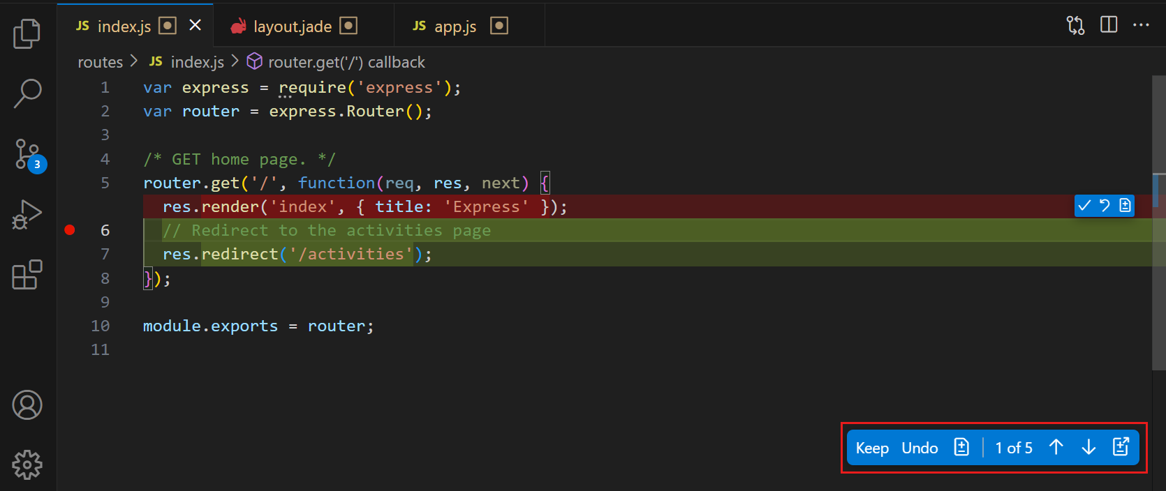

Accept or discard edits
Copilot lists the files that were edited in the list of the changed files in the Chat view. Files with pending edits also have an indicator in the Explorer view and editor tabs.
Screenshot that shows the Copilot Edits view, highlighting the changed files list and the indicator in the Explorer view and editor tabs.

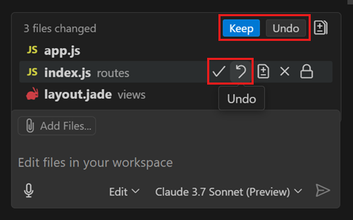

With the editor overlay controls, you can navigate between the suggested edits by using the Up () and Down () controls. Use the Keep or Undo button to accept or reject the edits for a given file.
Screenshot showing the Editor with proposed changes, highlighting the review controls in the editor overlay controls.
Use the Keep or Undo controls in the editor or Chat view to accept or reject individual or all suggested edits.
Screenshot showing the Copilot Edits view, highlighting the Accept All and Discard All buttons.

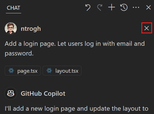

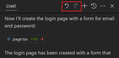

Revert edits
As you're sending requests to make edits to your code, you might want to roll back some of these changes, for example, because you want to use another implementation strategy or because Copilot starts walking down the wrong path when generating edits.
You can use the Undo Last Edit control in the Chat view title bar to revert the last edits and return to the state before sending the last request. After you perform an undo of the last edit, you can redo those edits again by using the Redo Last Edit control in the Chat view title bar.
Screenshot showing the Copilot Edits view, highlighting the Undo and Redo actions in the view title bar.
You can also use the Undo Edits (Delete) control (x icon) when hovering over a request in the Copilot Edits view to revert all edits that were made from that request onwards.
Screenshot showing the Copilot Edits view, highlighting the Undo Edits control for a specific request.
